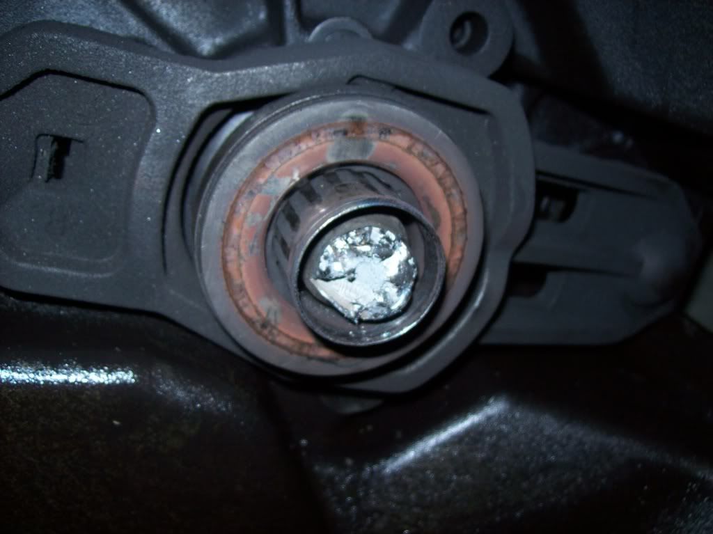

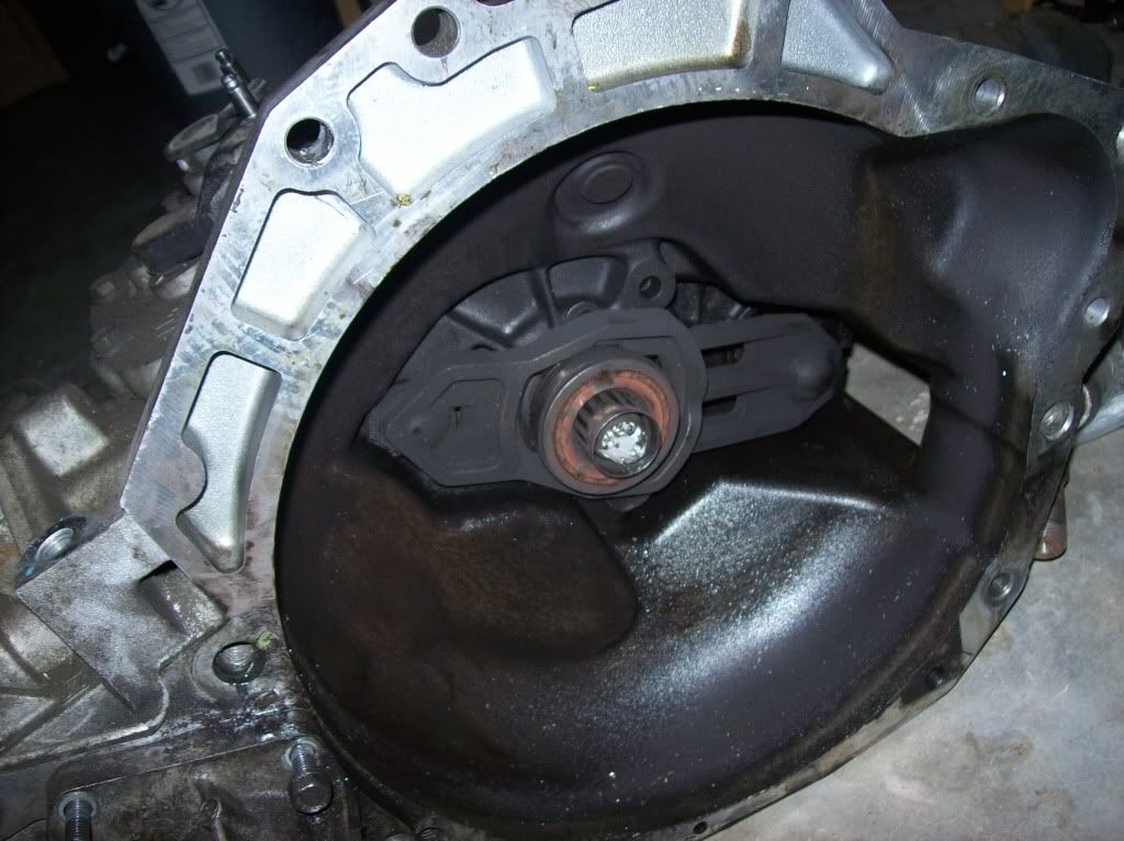

I broke my input shaft. I need to fix it ASAP, Wife can't get on base with her car.
I have been looking at this manual, but I't doesn't seem to be very helpful for now.
http://www.carbide-red.com/service_manual/18627-pl-trans_sgmldiag.pdf
I am wondering if this is something I can replace myself, or does a professional need to do it. I have never taken apart a transmission, but I am pretty mechanically inclined.
I have the origonal Throw Out Bearing, so I am going to order one from Modern, unless someone has any better advice. I also have the origonal Fork, so I was going to order aone from Modern as well, because my clutch engages right off the floor sometimes. I have a welder, could I just repair the fork in the area where it is worn? Or bad idea?
After my ACT clutch install about a year ago. My trans makes a "tapping" noise when the pedal is out. Push pedal in, no more noise. how can I avoid that rattle when I put everything back together?

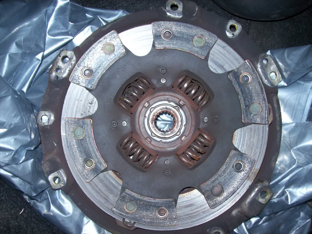

I see my fly wheel looks a little scuffed, I think I should get it resurfaced. Good idea or bad? Its only about a year old.
I understand the stock input shaft has a flaw, being the area where the diameter gets smaller , the typical breaking point. How do you avoid that? It that the "weld mod.?"

So this is what I need to do? I already have trans out of the car tho.
I'll start taking her apart tomorrow after work. Anyone wanna come over and watch, or help, you would be very welcome. This will be my first trans dissassembly.

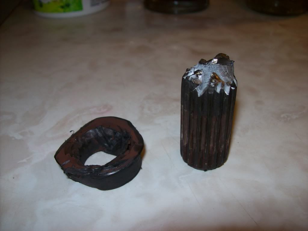

FML. :stab: No I cant get the bearing off. I am guessing it's the "bearing sleeve." The tip is mushroomed.
I don't have a press, but there is a machiene shop down the street.

Do you know what caused the shaft to break? Did you used to WOT shift?
I got the S1 kit a few years ago and WOT shifted all the time. Never had problems. Now I am S2 w/ toys and DSP tuned for Meth. I WOT shifted from 3rd to 4th and broke the input shaft. :crying:
I rarely WOT shift, but I wanted to datalog my knock on my self-tune for meth. 1.5KR.

Here are some pics. I pressed out the gears, and kept them in order for reference. I still need to press out the mushroomed TOB sleeve. Here's my progress. Guys, if you have a press and a dremel, this is not hard at all. Jtmoney's threas is frikken AWESOME! I am saving alot of money doing the work on my own. I am learning trans trouble-shooting, from all the trans threads I have been reading :readclose , and I becoming more confident in my own trans work. :ninja: :thumbsup:
