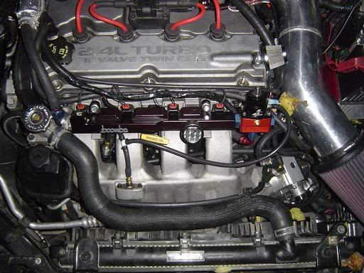

ok i have seen alot of fpr's mounted like this but i was wanting to change mine to this way because it looks alot cleaner but i wasnt sure if it was just hanging there on the rail or if its mounted to somthing i cant see, any info?

my question... why is the fpr attached to the intake at the map sensor position???

I have mine mounted like that. It's not mounted to anything

is your battery relocated?
also when you attach your fpr to the cold side pipe, where did you attach it? to the bung where the red vac line went???

Mines mounted on the rail. Very clean visually and saves a lot of space. I'd imagine it would take a lot to break the fitting.

that's cool. 8N fitting is pretty beefy--its not like its hanging off the end of an 03 rail. Too bad the cops don't appreciate that sort of stuff. mine was set up just like spindlers, i even have the same battery. Cop thought the braided lines were nitrous.

with that vac line tee'ing off the map sensor it sees vacuum......its supposed to be attached to a boost only source for example, the cold side pipe
so where on the cold side did you put the fpr line? on the tip where the red vac line used to go?

And yes, the boost source for the FPR is coming off the red nipple on the UPP. I just pulled the rubber end off the hard line and inserted a vacume T.

that's cool bro.. i was actually asking anyone who would answer. haha. i'm doing this mod this weekend and needed to know where to get boost from.

well you can see the drycell battery, i bought a JMB ultimate intake and that comes with it, now i use one of the two pipes that came with as the intake for my 60-1, and the vac line is attached to teh coldside pipe, theres a bung on that pipe for a nitrous nozzle and i just found a fitting with a "nipple" on the end that had the same threads as the nitrous fitting:D

i personally thing mounting it on the rail is the cleanest location...
