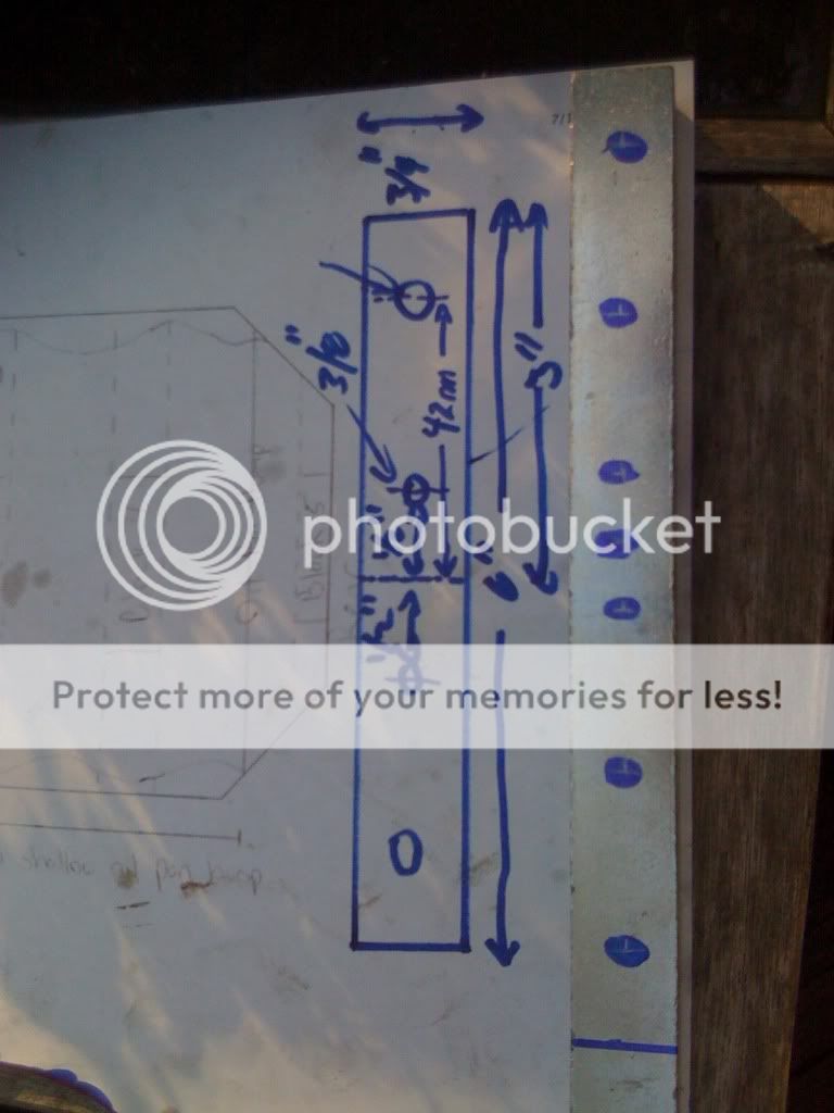

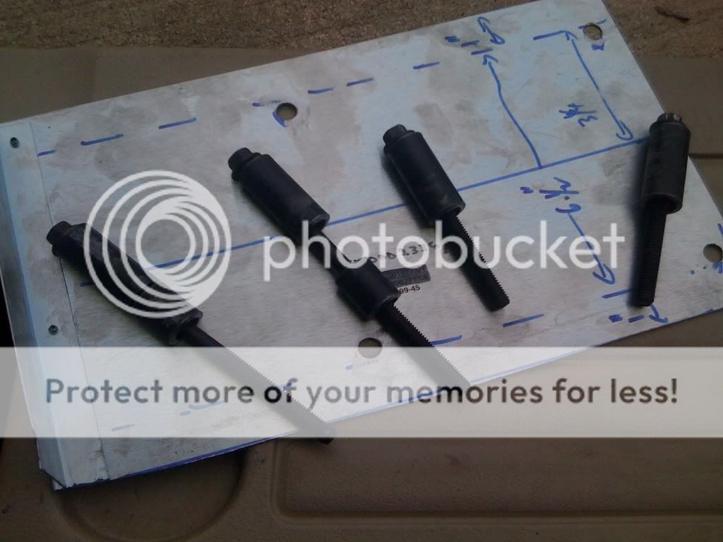

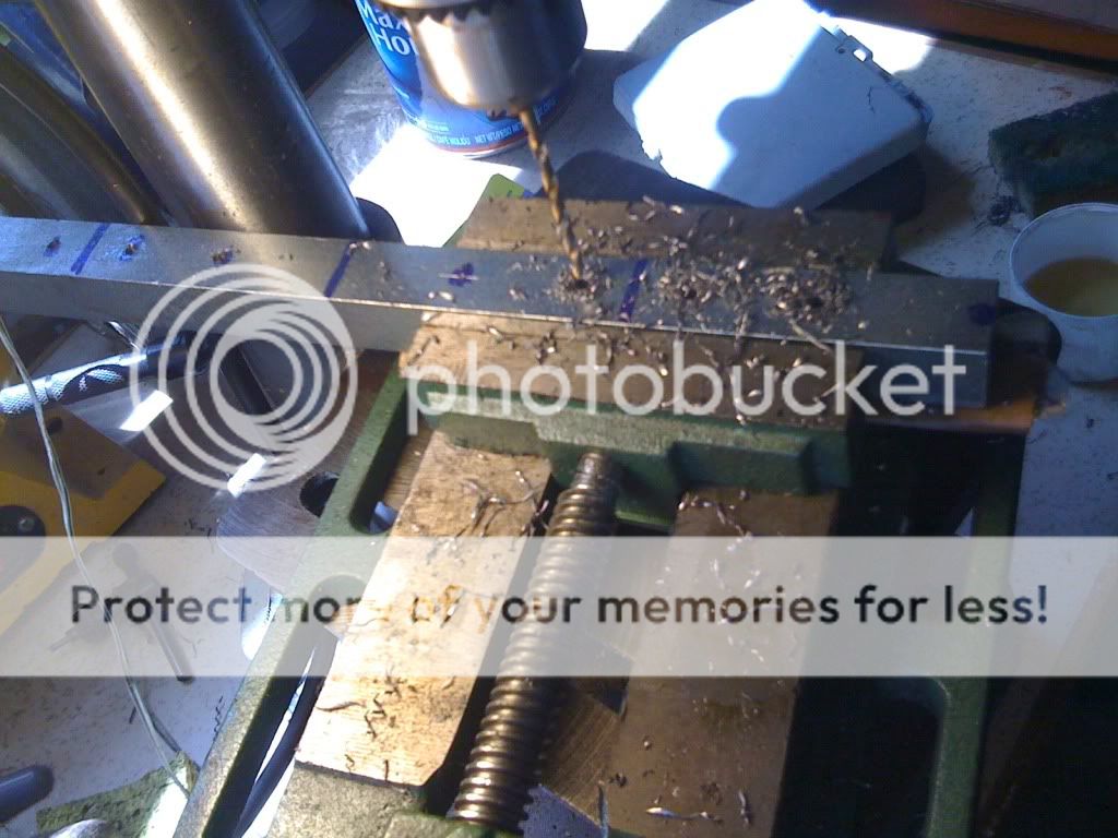

i think the 47# wheel is my limiting factor, w/o water injection 25#'s of boost, w/WI maybe 28#'s -- and bottom end is built for more (strap etc) -- DCR respected name claims 800hp w/aluminum-6061 strap -- i made mine from steel (stronger) -- so it should be around that, doubt i could push 800-900hp w/o breaking an axle or input shaft
http://www.srtforums.com/forums/f258/new-dcr-direct-fit-6061-crank-strap-kits-594226/#post8925311
Steel doesn't always mean stronger.
many moons ago i took a class where the lab involved measuring the strength of metal -- hence my thoughts of AL vs steel <given same dimension 3/4" x3/4">, here is the link http://www.srtforums.com/forums/f169/wanna-build-your-own-direct-fit-strap-kit-608075/index2.html#post9181301
besides the material, i do agree a machine bed plate has its advantages -- but with my build goals a direct fit is more than enough

Simple aluminum of course is weaker. But the stuff your supposed to use for strength, trumps steel an all aspects. Just FYI. Steel doesn't mean stronger otherwise they would use more steel on my daily toys, commercial aircraft. It's all aluminum, Ti, but mostly AL.
sorry don't agree, per unit volume, 3/4" x3/4 steel is stronger -- read the wiki links i've posted.. or search (fwiw.. i don't claim to be an expert, but i've read a few of the spec sheets)
planes use al because its stronger per pound per dollar - if dollar wasn't an issue they would use Ti or carbon fiber, etc
bridge/skyscraper strength .. yada yada yada
Now your stepping into troubled waters. Anything produced within the last decade aircraft wise is over 90% AL,TI, or composite. Ti is used because of the abundance of strength per lb and it's anti magnetic characteristics. There's so much computers in a plane that those little added features keep you from becoming a lawn dart.
My babies that I work on now EMB 190's have complete hardware made of Ti for that reason. It's cost effective abd strenthover steel period, same with aircraft grade AL.
6061 AL is one of the last strengths before progressing into aircraft grade AL, they make cyclinder blocks and heads from it just for reference of strength.
And you do realize that the new bowing 787's complete fuselage is carbon fiber right?
And most school institutions do not allow wiki as a source reference because it is user produced material and easily manipulated.
Steel is old school, still used for city level cost effectiveness yes but by far not the king of the ropes anymore.
I'm assuming your just in the old school way of thinking, which has nothing wrong with it just make sure you look at the whole picture not just one.
here are the spec's and data sheets
< way more than I need>
low carbon steel = 60,000 psi
t6061-0 =18,000 psi
t6061-6 =40,000 - 45,000 psi depending on heat treatment
http://en.wikipedia.org/wiki/6061_aluminium_alloyhttp://en.wikipedia.org/wiki/6061_aluminium_alloy
http://www.fastenal.com/content/product_specifications/KS.OS.SQ.P.pdf
