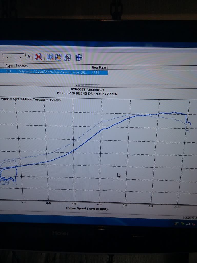

First Dyno of Project Blue Sled from Pfi-speed. The 3rd dyno pull on just 18 psi, revving to 6400 rpms the car made an impressive 512whp/497ft lbs sae corrected. The car should make giant power after the turbo comes back from being rebuilt tje comp wheel touched the housing and broke fins.
Here is the Video:http://www.youtube.com/watch?v=a3BNd0DDPqA
Dyno Graph:
Excited to see what the car will do...fully dailed in and tuned :eveilgrin
Thanks Kevin Warren and also James (Ghost-1) who has been helping

Thanks guys, Sean and I are so excited to finally have it running and done! Im so surprised at the numbers already on low boost without alot of tune time.

As of yesterday with the Help of Kevin & James. We decided to order a new Precision 6765 Billet wheel, journey bearing, .82ar , Anti surge Ported S cover.
Should come in begining of next week so Kevin can get the car back together. Car should GAINT power now with this turbo since its been doing very well with the Evos
