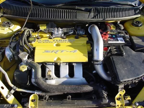

Damn, what paint did you use on yours....that looks great....thinking of doing the manifold next....How hard was that one....looking good....Have a polished injector cover coming soon....so the manifold will be next...
4,100 Posts
The blue on mine is Krylon Plastic Fusion Paint.
I then took off the paint on the letters by razor blade and used a silver paint marker to color the letters in and used the marker to have the instructors sign it.
oh, and the valve cover and intake are powder coated by glacius.

Damn, how is that Krylon holding up with the heat....
4,100 Posts
not sure.. LOL..only put it on the car when i show it. I have a stocker under the hood when i drive.

Here is an update with a little extra shine on the new injector cover....flash hit the cover too much I think......

Take one in the daytime. Looks good. How much time and money to do both?
718 Posts
Discussion Starter · #16 ·
It was $30 for the stainless injector cover, and it took about $10 in material to do the valve cover and about 2 hours of actual work....Keep the car down at least 24 hours for the paint to cure though...$10 included $5 for paint, and $5 for brake cleaner spray....Fairly easy and very cheap....Still have about half the can of both, so I guess it cost $5.......
