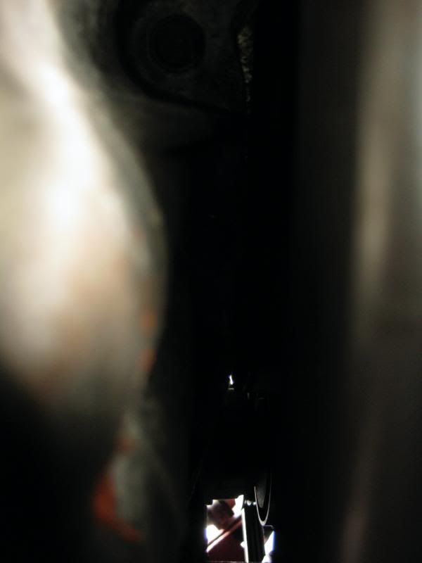

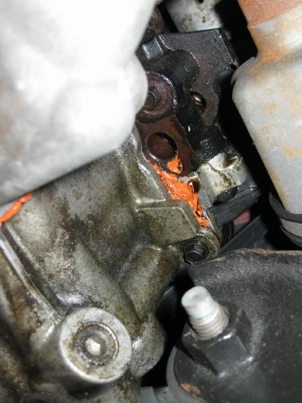

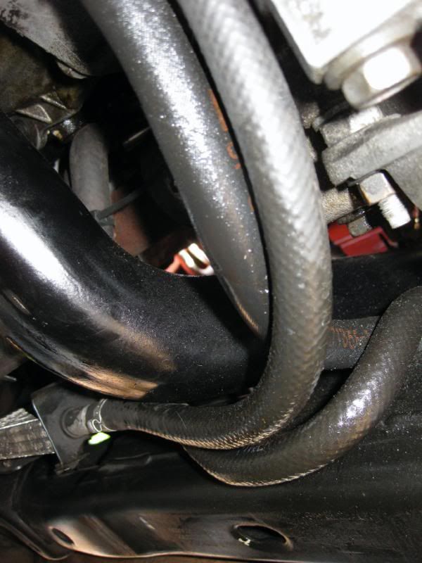

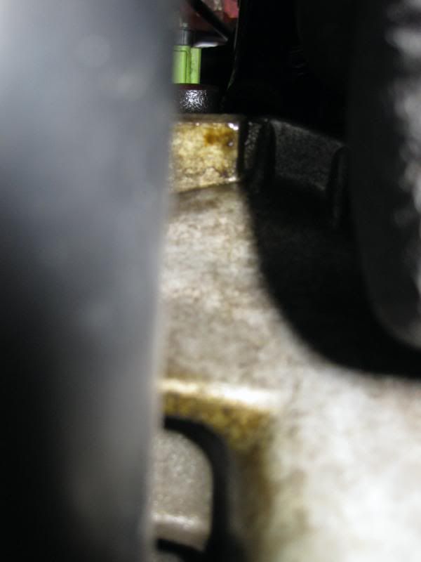

well the car has been leaking oil for about a year now..i have had the crack seal and oil pan gasket replaced at 30k cause they were leaking..and i found leaks again a year ago..67k on car now..so far i have replaced the oil pan gasket again and replaced the oil pressure switch..i cant tell if its leaking from the crank seal again or not..or if its leaking for a some oil hose which i dont now which one..here is some pics to show u guys whats up..i am losing about a quart of oil every 2 weeks

Check your trans output seal. Mine leaked it and flings it everywhere. Also looks like you lost a bolt on your charge pipe.
yea charge pipe i onl have one on there...trans output seal?..where is that?..and that would leak engine oil and no trans fluid?

DOes look like it's from the back of the engine and somewhere in and around the area of the turbo lines. The oil pan is moist over a large area.

cam seals on the passenger side - leaking down behind the timing belt cover
maybe oil return line leaking at the turbo or where it goes back into the block.
yea i checked all the turbo oil lines and ajusted and tightened the clamps..idleld the car and no leaks from those lines..the only things i can think of is the cranks seal again and or the cam seals..now i would need to remove all of the motor mounts and timing belt cover to see if these r leaking correct?
2,346 Posts
You could take the top timing belt cover off and see if the timing belt is wet. My car has a bad front crank seal leak and the timing belt gets oil on it and carries it up and slings it on to my hood, since the cover is still off. FYI the cover is only 3 small screws, no jacks needed.
