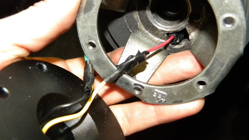

Okay so everyone is trying to figure out how to keep there horn and have an aftermarket steeing wheel at the same time. Well I have the "fix" I also even have a NRG quick release hub for those of you who own one of those.
First off you need to take apart you stock steering wheel, find the red wire that has a connector on it, you will need to cut it off. connect it back to the one in the car and feed the wire through your aftermarket hub.
After that you need to make a ground wire, I choose to just ground mine off for the time being on the main steering wheel bolt, just to make sure my setup worked.
Next if you have a Quick Release like me there should be two wires that come off the bottom (one is a ground the other is power) attack your ground to one and attach your red wire to your power. Also I only used electrical tape for the test, after everything worked for a week, I went back a soderd the wires together for a clean and better connection.
After you have accoplished this, take your horn button and connetc the two wires from the inside of your Quick release and attach them to the button:
Now put everything together and the horn should work, mine has been working for 2 years now and no probs what so ever :) good luck guys.
