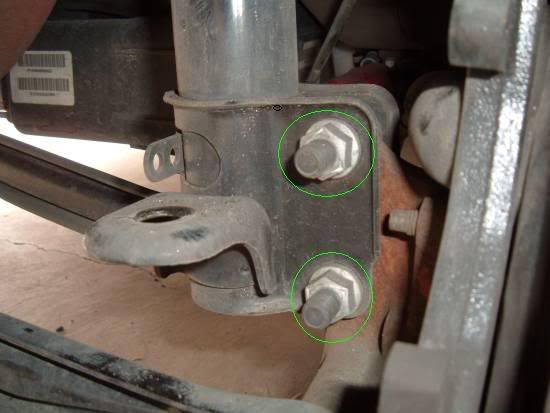

5) Remove the two bolts attaching the strut to the steering knuckle. MOD EDIT: After removing nuts (18MM), bang the bolts out (or in when reinstalling). Do not twist them in or out)

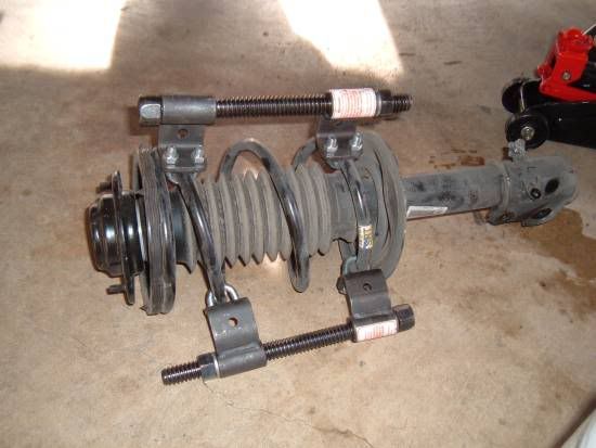

9) Position the strut assembly in the strut coil spring compressor and compress the spring. MOD EDIT: (Spring compressor not needed for the rears if air tools are used, or if a strong helper pushes down on the spring)

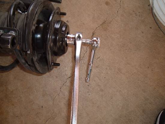

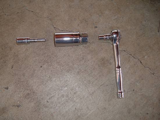

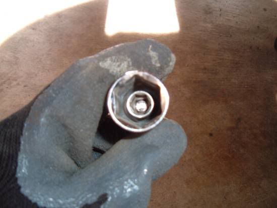

10) Stick a 10mm socket onto the top of the strut with a 1/4" extension in it. Then slide a 13/16" spark plug socket(with the rubber removed)over the 1/4" extension. Hold the extension in place and slide a cresent wrench onto the plug socket and loosen the nut with the cresent wrench.
11) Disassemble the strut and coil.
12) compress the new spring and reassemble the strut/coil in opposite order.

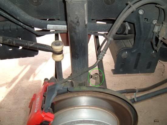

2) Remove the screw securing the ABS wheel speed sensor bracket to the rear of thestrut assembly.
3) Remove the nut from the end of the rear stabilizer bar link bolt. Pull the bolt out through the top of the link and remove the link.

6) Remove the two nuts and bolts attaching the strut to the rear knuckle MOD EDIT: After removing nuts (18MM), bang the bolts out (or in when reinstalling). Do not twist them in or out)

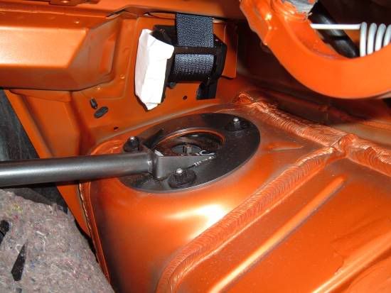

7) Open the deck lid. Remove the carpet from the top of the strut tower.
8) Loosen, but do not completely remove the 3 nuts securing the strut assembly to the strut tower. Grasp the strut assembly to keep it from moving, then remove the 3 mounting nuts at the strut tower.

12) To place the strut assembly into mounting position, start the lower end of the strut over the top of the knuckle and down the back between the two lateral arms. Next, lift the top of the strut assembly up into the strut tower aligning the studs on top of the upper mount with the three mounting holes in the strut tower. While holding the strut assembly in place, install the three mounting nuts on the upper mount studs inside the luggage compartment.
13) Tighten the 3 mounting nuts to a torque of 34 N·m (300 in. lbs).

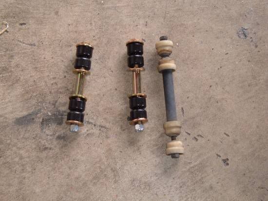

15) Reinstall the stabilizer bar link. I was recommended to use shorter endlinks. These are Prothanes

you got my number if you got any questions. There's another how to that's stickied on how to do this. When I did mine I followed that how-to. One thing to remember is that the clevis bolts are ribbed. Don't twist those bolts. tap them out with a hammer/rubber mallet and do the same when reinstalling:thumbsup:
