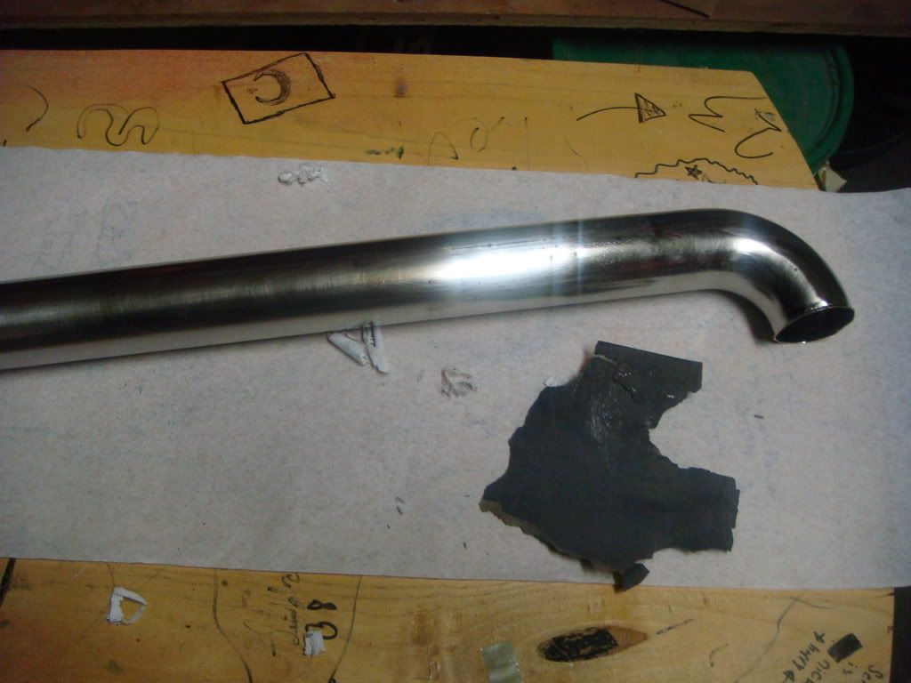

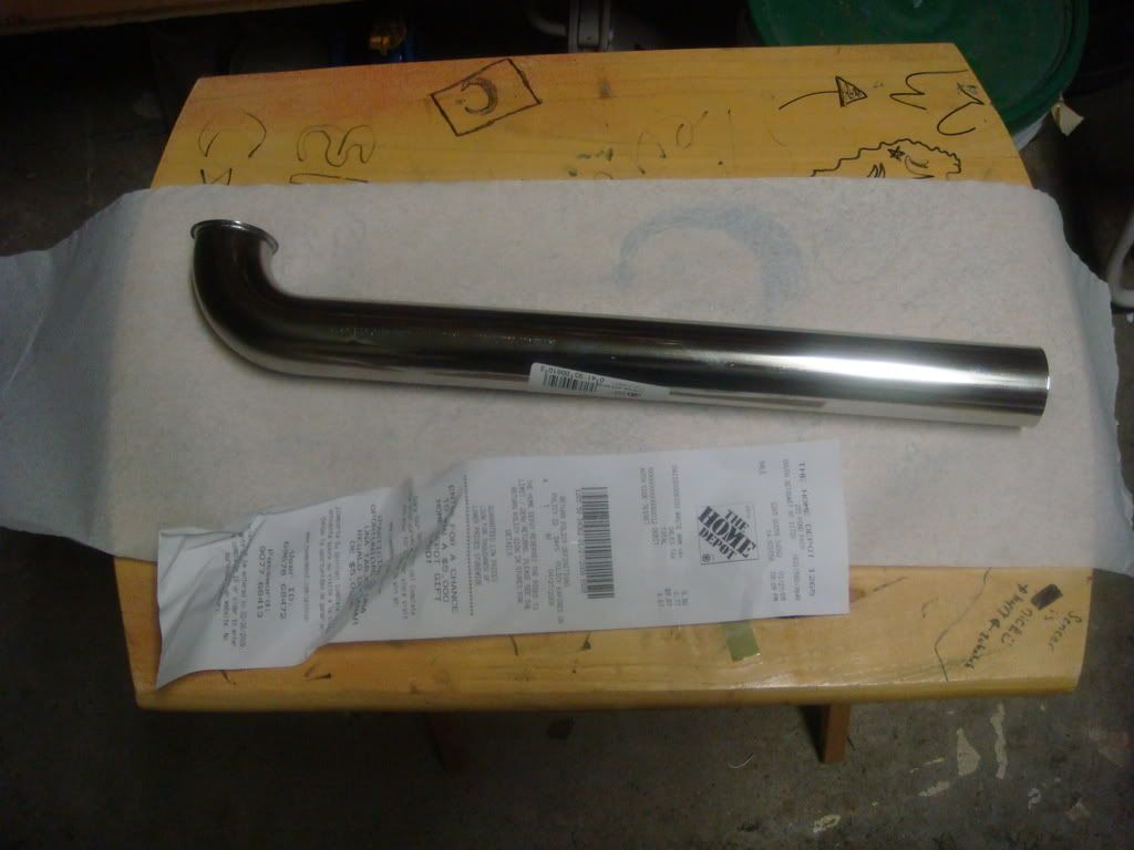

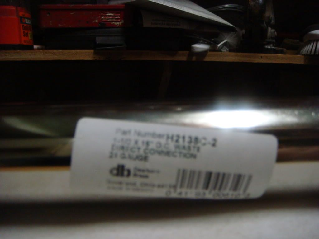

1. Go to Home Depot and in the plumbing section, in the sink repair pieces you'll see a 1 1/2 diameter and 15" long metal pipe(long L shaped) part number H2138C-2, buy that and also buy two or four worm clamps while you're at home depot.

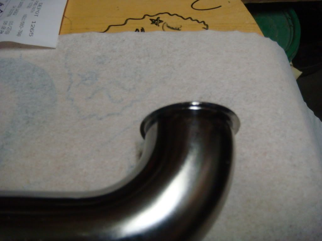

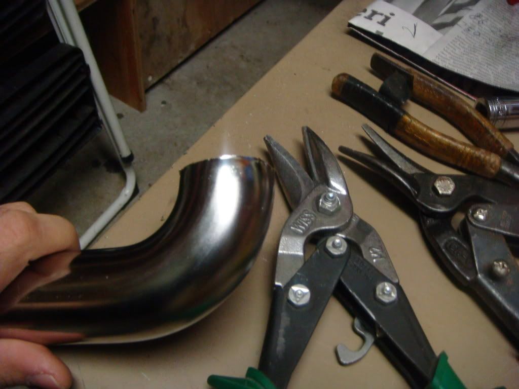

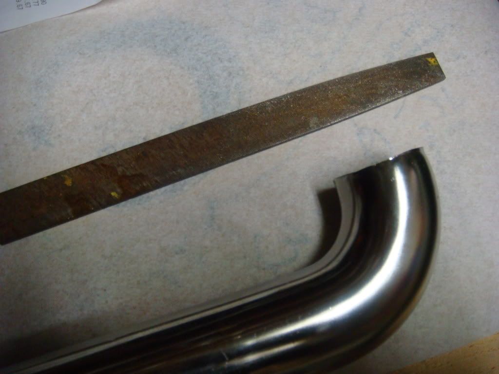

2. Next you'll need to trim the head after the bend. If you have some heavy duty scissors you'll be able to cut it or you can use a grinder to trim it. Be careful not to alter the roundness of the pipe.
3. Now you'll need to sand the rough part, so you dont rip or damage the rubber which it'll attach to.

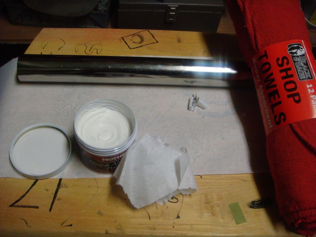

5. If you decide to polish it take out some mothers polish and start polishing it.

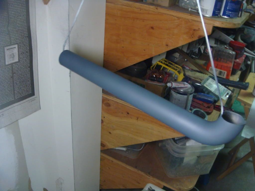

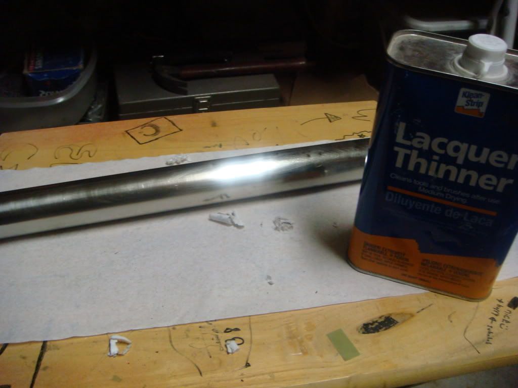

7. Next use some liquor thinner and make sure no dust is left on the pipe.

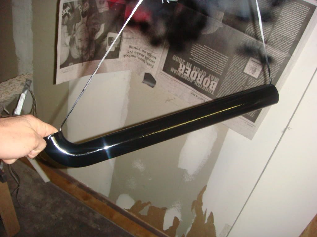

8.Now you'll be priming the pipe. I highly suggest you use hi heat primer so it wont start peeling after a few heat cycles.
9.Wait until the primer is dry and apply the paint of your choice. Again make sure to use hi heat paint.
10.Next is optional, you could clear coat it to give it some protection and little shine to the paint so thats up to you.
11.Wait a day for the paint to cure before touching the pipe.
