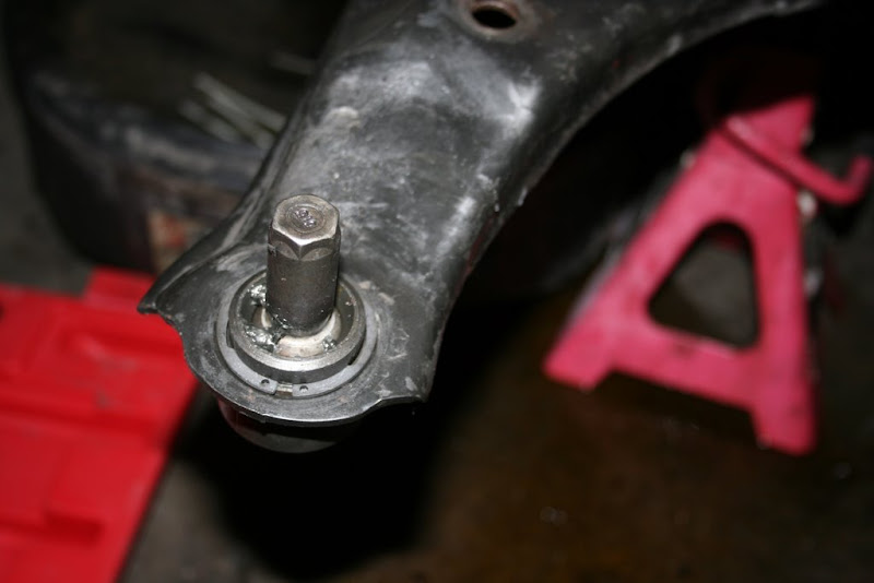

Remove Ball Joints:
Step 1: Open Beer (Repeat as necessary)
Step 2: Remove worn ball joint boot using the end of the flat head screwdriver

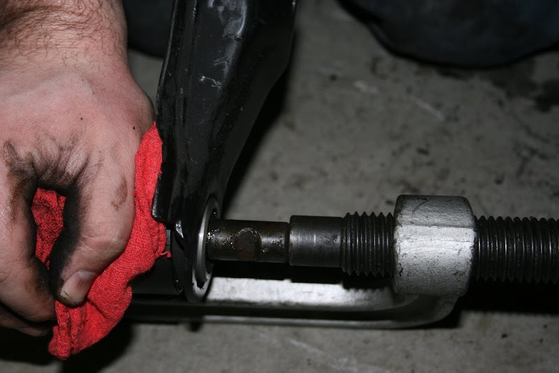

Step 3: Clean off ball joint surface with a shop towel.

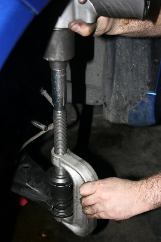

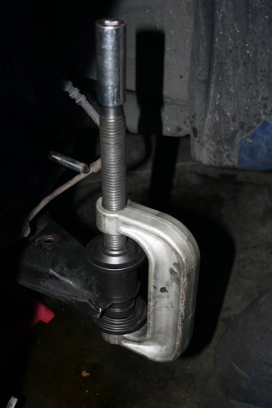

Step 4: Assemble ball joint press pushing the ball joint down through the LCA (If you do it the wrong way, it wont budge...don't ask me how I know...)
Step 5: Once assembled use your 7/8" socket and 1/2" drive ratchet/breaker-bar/impact to tighten the press down on the ball joint
Step 6: Continue to tighten, the ball joint will begin to slide out of the LCA

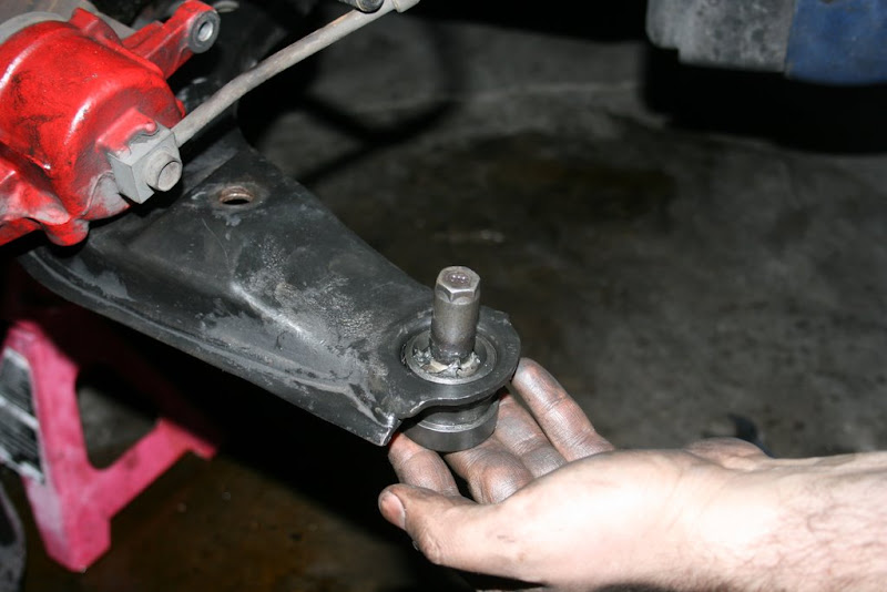

Step 7: Once the ball joint is free, it'll all probably fall the to the floor...like so.
Step 8: Admire the old ball joint.

Ball Joint Install:
Step 1. Locate new ball joint.
MOOG PN K7147
or Mopar PN 04656010AE and 04656464AA
Note: The MOOG ball joints come with the boot, ball joint, and pinch bolt. They also have a grease fitting so that the ball joint may be regreased later. The Mopar ball joint, boot, and pinch bolt must all be ordered separately. I do not know the PN for the pinch bolt. I happened to have both parts here, but will be continuing this How-To using the MOOG ball joints. I will also continue assembling the ball joint with the LCA installed into the vehicle. Follow the above mentioned How To for instructions to reinstall the LCA.

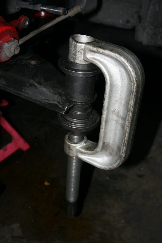

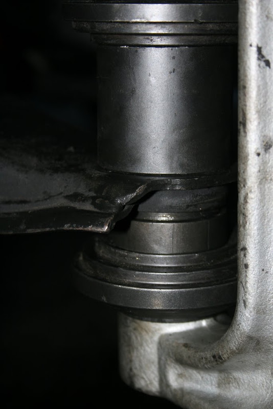

Step 2. Install the ball joint from the underside of the LCA
Step 3. Assemble the press so that it pushes the ball joint up through the opening in the LCA. My particular press' plates are slightly different so make sure you put the correct one on each side.
Note: After installing the press as show above, I noticed it would be easier to get my impact gun on it if I flipped it upside down. Your mileage may vary.

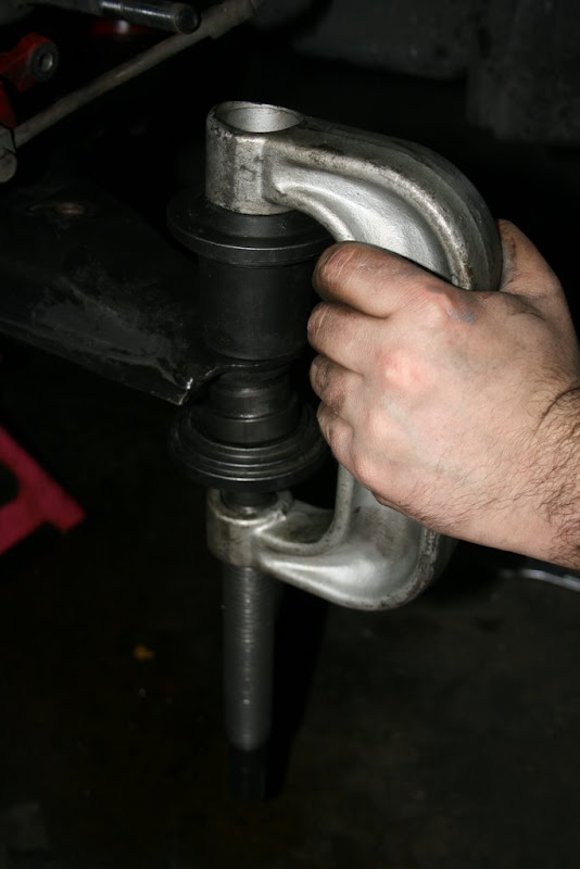

Step 4. Tighten press using impact gun, 1/2" ratchet, or breaker bar
Step 5. Continue to tighten the press and make sure the ball joint installs straight and completely into the arm

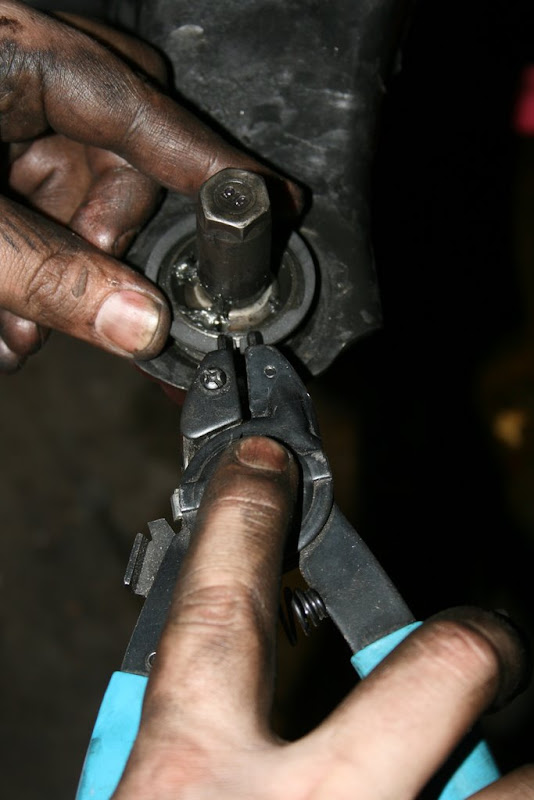

Step 6. Install included snap ring using snap ring pliers.
Step 7. Using an adjustable wrench, rotate the ball joint so that the notch cut out is parallel with the vehicle and will line up with the bolt hole in the knuckle
Step 8. Install knuckle, and new pinch bolt and nut. Torque to 70 ft/lbs.
Step 9. Install grease fitting, taking care not to over tighten, and pump ball joint with your favorite grease.
