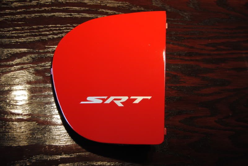

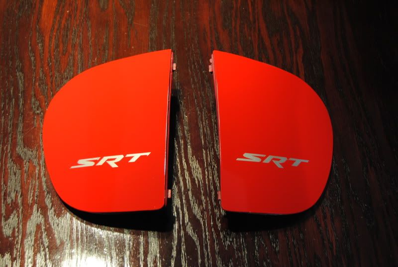

Made a set of custom foglight covers. Used the stock plastic foglight surround, glued a piece of thin lexan to it and painted to match with a SRT stencil. :)

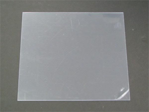

- A couple of Lexan sheets. You can get them from hardware stores. Each about the size of a sheet of paper, and get the thinnest one since it needs to be flexible.

2. Lay the plastic surround face-down on one of the lexan sheets and trace the outline onto the lexan with a marker.
3. Clamp the 2 lexan sheets together.
4. Cut around your outline with a dremel or saw. When done, you should have 2 identical foglight covers.
5. You will notice that the stock foglight surround is not flat, rather the face has a slight curve. Heat up the cut-out with the heat gun (only a little bit - stop when the lexan starts to turn cloudy), then grab your gloves and while the lexan is hot, carefully bend it to acheive the same contour as the stock foglight surround. Take it easy and repeat the heating/bending procedure a few times till you get approximately the same curve.

10. Now make your stencil. Find an image you want to use and print it out on the envelope label. Here is the one I used:
11. Cut out the lettering with your knife.
12. Stick the stencil onto the foglight cover; make sure you press it down well.
13. Mask off any other exposed areas then lay down 2-3 coats of colour for the letters.
14. Let the paint dry well, then remove the masking. Wet sand the cover with 800 grit (there may be some residue from the labels, it will be removed by sanding). Sand lightly with 1000 & 1500 grit to get a nice smooth finish.
15. Spray 2-3 coats of clear. You can wet-sand in between coats for a smoother finish. It's up to you but not entirely necessary.

I only removed my foglights because one was busted. Threw these on while I think of something else to upgrade them with.
