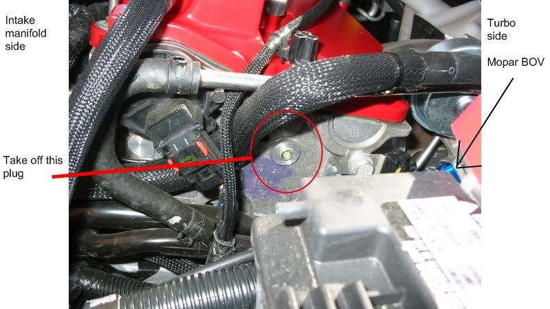

yea i went out and just got hte oil press. guage...i asked hte guy and he said its a pain in hte ass to get to hte little thing i have to connect, that i have to take the axle or sumthin off...bs haha...what sides it on n how hard is it rally
There is a little block off nut on the drivers side of the head that uses a square-head bit to get out. I just used a wide flat-head screwdriver to get it out.
Put the oil pressure sender there, run the wire to your gauge and voila. And yes, the sender will clear the intake. I'll post some pics of mine when I get home from work.
*edit* Just go here and look half-way down the first post.
http://www.srtforums.com/forums/showthread.php?t=246486
Ignore the whole 'brass extensions' thing. Just put the sender directly into the head. Make sure you put some teflon tape around the first half of the sender(next to the main body) to prevent leaks. But leave the second half bare so it can maintain a good ground with the head.
^^ True words of wisdom, really easy install. I have my oil press on one, and my oil temp on the other.:thumbsup:
this is where the bolt is that you have to remove. Its fairly easy. I grinded down a screw to the shape of the square.
Or you can just use an square apex bit. Whatever you have. NOTICE, there are two of these the other one is covered up in the pic, doesn't matter which one you use.
