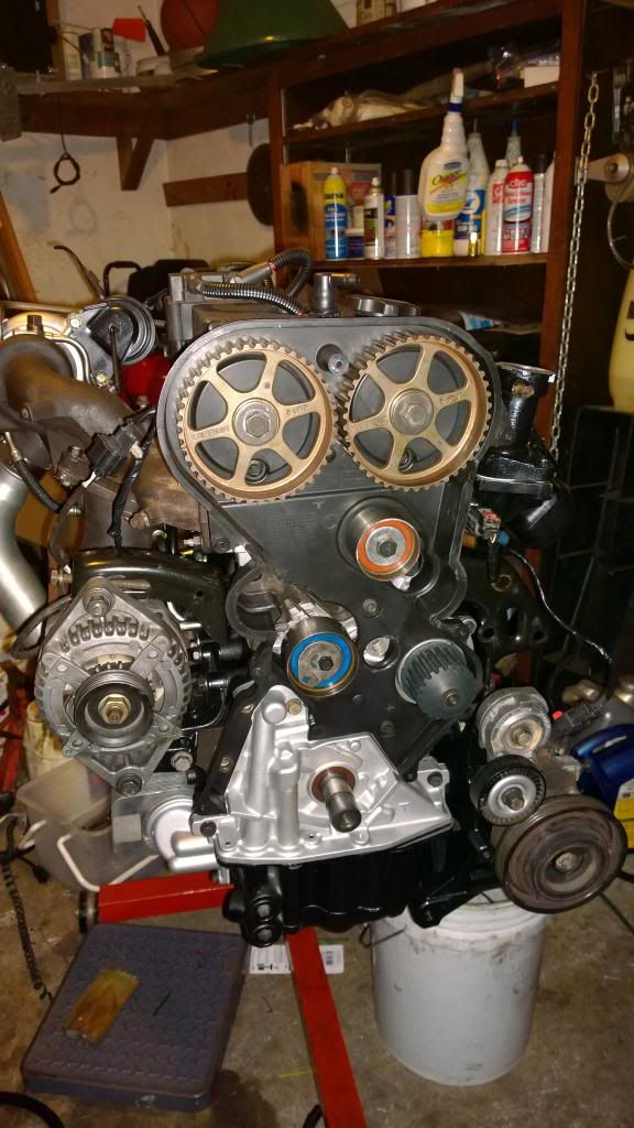

toming officially done. omn the first try! well, something are bound to go ok, right?
timing belt covers in as well as bracket...this braket takes 2 mins to put in and out when the engine is out but takes about 45 mins to put in and out with the engine in the car..fuck you dodge!
