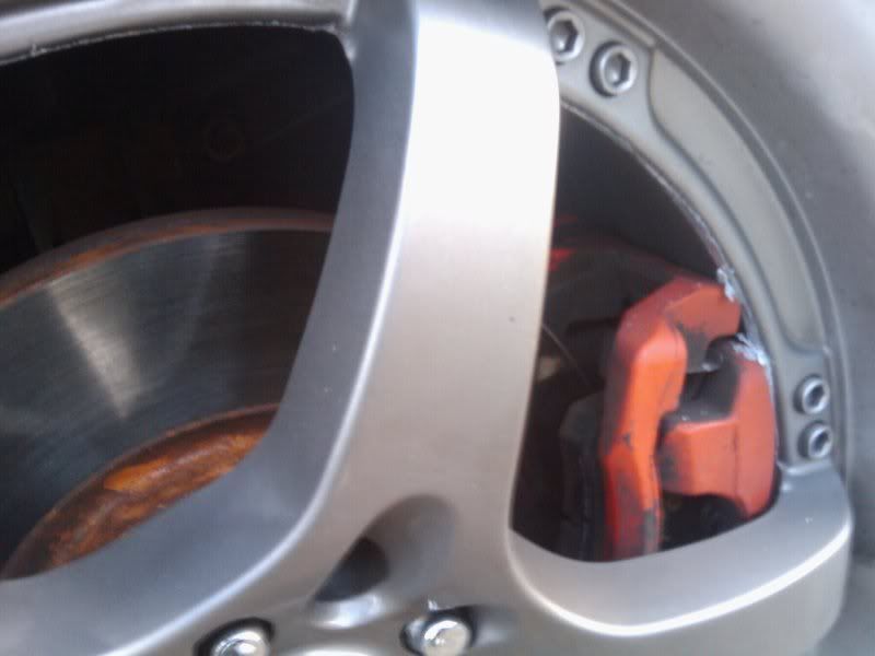

i didnt realize what happened until i got it towed home... busy highway couldnt walk around the car. about a week ago i started hearing a noise which i thought was my shocks on the front right side starting to go... since only heard or felt it when i hit any small bumps. but after reading other threads sounds like it could have been a loose bolt on the caliper. i did the last rotor and pad change about 3 months ago. i havent yet taken the wheel off because my jackstands are lent out to a friend. i just think i would have felt a loose caliper before something like this happens. there was no pull when braking or anything, just all of a sudden this. i just want to know how much damage it has really done and if it is something me and a buddy could do(he knows cars more than me lol) or if i should just take to a shop
pics taken with cell... will update as day goes on

okay yeah it must have been me when i did the rotor and pads :stab:... bolt was loose, didnt fall out. put it all back together, havent driven it yet but i will do a once around the block soon. didnt look like the rotor took any damage. caliper is scratched a bit. the wheel took most of the damage. but i was going 120 kmh on the highway when this happened so i think ill get it checked at a shop still...

Did you torque the bolts? I just took off a calipers and the bolts seem a bit small-I am going to use med lock tight after seeing this pic>:mopar: Oh, what is the torque on the caliper bolts?

looks just like mine did :stab:
