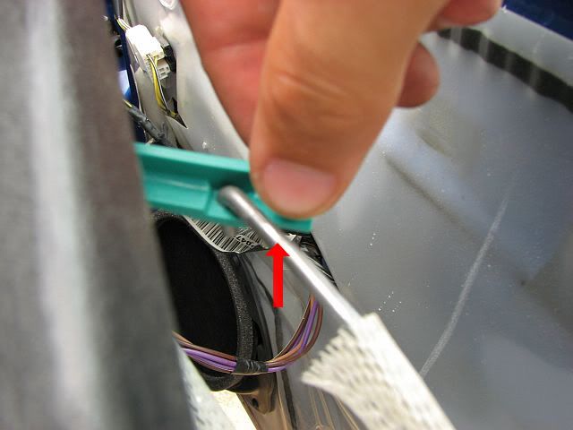

First things first, remove the 3 screws holding the door panel on:
Here is where the pick tool comes in handy:
Next use a panel popper or flat head to remove the window switch cover like so:
Once you have popped out the switch cover, remove the harness attached on the back:
Now that all of the screws have been removed and the harness unplugged. It's time to start popping the panel off the door. Use some small force, here is where the panel tool comes in hand. Go around the whole panel until all of the clips have been popped free:
Next you'll need to unlock the push rods for the window and door lock. Push away on the plastic locks that cover the push rods. Once you have done that, you need to pull the rods out of the clips.
Then lastly you can unhook the door lock harness from the back of the panel and remove the panel from the door.
