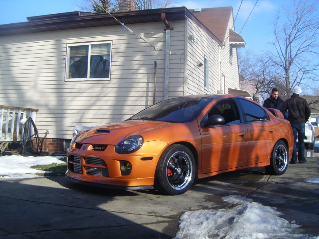

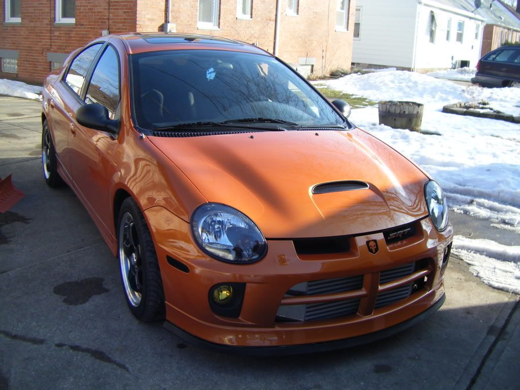

Here is my 2005, did them myself, no cutting
