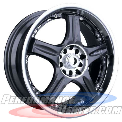

think they'll fit without sticking out or rubbing?
18x7.5 with 45mm offset
18x7.5 35/43/48mm
18x7.5 35/48mm

For the ICON wheels you will most likely need some 5mm spacers. The wheel is identical to the one below (not sure what brand) and his offset is 40.
For the Copse perhaps the 43 offset will fit, MAYBE a small spacer.
The FN01R-C I will not comment on because I want those wheels first!

The spacers are needed to allow more caliper clearance. Wheel design plays a big role on whether or not they will clear the brakes.

I think it will rub the front brake caliper. Use a 3mm/5mm spacer in the front will do. Buy a hubcentric to fix the vibration.
