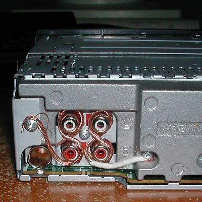

6. Grounding the RCA's on the head unit
Many have had problems with Pioneer head units because of a poor internal RCA ground. To remedy this, simply wrap wire around the RCA's and screw the wire down to the head unit's chassis like so:
