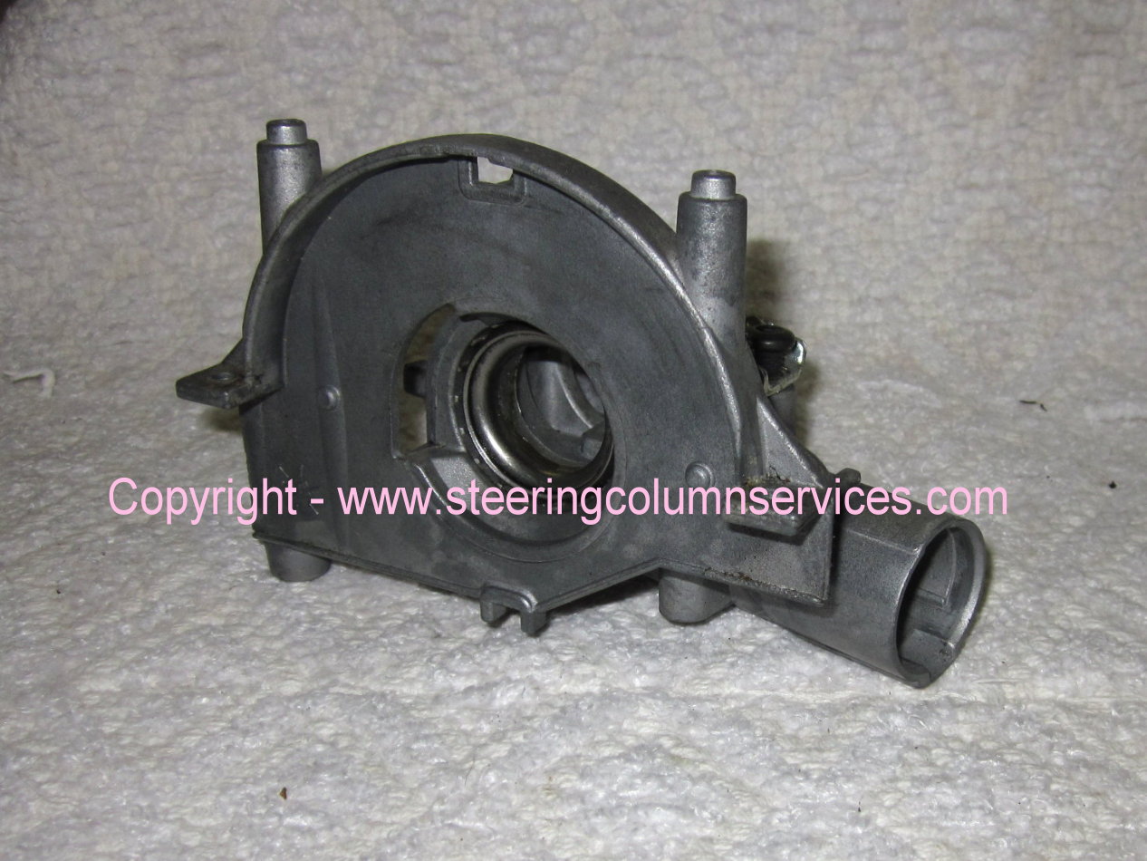

I would really like to know what you find! I have done A LOT of searching for pictures, and this is the closest I have found.
These are actually from a website about converting a Gen2 Neon into a rally car…really cool! Here is a link: rallynotes | A site about building and racing a rally car in the United States.
I don't see any sort of bearing or bushing, but at least it shows a little. PLEASE take a few pics, or at least give me a good description of what you find! I wonder if I can weld (actual or JB, LOL!) a sealed bearing between the shaft and the tube.

I contacted them, and this was their response:
Thank you for visiting and contacting us through Steering Column Parts, Replacement, & How to Instructions. We provide steering column parts and repair information worldwide.
The bearing is not servicable. You will need to replace the upper lock housing to replace that bearing. Chrysler does not sell this cast piece separately, but we do. Here is the part (dodge chrysler plymouth steering column housings and bearings hsg04 cast housing assembly | Steering Column Services) and here are the instructions (dodge chrysler plymouth Ignition switch and Lock Housing replacement Instructions | Steering Column Services) on how to replace the assembly the easiest way.
I hope this helps
Customer Service
Steering Column Services.com
1301 Big Soldier Ct
Ivins, UT 84738
I suspect that this is what I will end up doing. I don't want to take everything apart twice, but I may have to just to see what's going on before I pay $145 for a part. I don't understand how this could get loose, based on what I am looking at here.

So i got everything off the column except this piece
Since there is a bearing inside you think this piece could be pressed on.
The manual i have says its not replaceable so they don't say how to get that piece off

Would you be able to post a couple of pictures of it? steeringcolumnservices.com offers instructions for $18…I figured I would not need to order them, but now I am reconsidering…LOL!
If you look at the picture in this link, it looks like it is clamped on with two torx nuts on the top, and the ignition lock cutout keeps it in the right place. Is it more complicated than that?

I emailed the company asking them about this part and this is their response
Hello Gary:
The housing is clamped on but the inner shaft needs to be removed to release it. We have step-by-step instructions here on exactly how to replace this part in the car.
I'm not really looking to spend $18 on instructions that i really only need for bascially one step.
I will most likely pull the whole column this week and try and figure out how to release that part.

I have figured out much of it from looking at the front and back pictures of the part, the pics I posted earlier from the rally car website, and from a couple of videos about replacing the ignition lock. Some pictures of the upper bearing area might be helpful, as well as a description of how it comes apart and goes together.
The guy I talked to said something about the steering column being spring loaded to hold it in place.
I got sidetracked this weekend when I had to rebuild my washing machine, but I'm about to order the part. I think I will go with the cheaper one and move my stuff over from the existing part. I need this to go smoothly since it is my only functional car and I don't have time for stuff to go wrong, so I may buy the instructions. Maybe we should split the cost of the instructions since we are doing the same thing...LOL!
BTW, th videos show that regular torx bits won't fit...they are some sort of security type with a hole in the middle. Maybe everyone else already knows this, but I would not have been happy to discover that part way through, so I thought I would mention it!

The more expensive housing is for an auto transmission. You will have to mod anyway so in my opinion, it is not worth it.
I originally bought kit 5159136AB thinking that it had everything, but as I know now, it did not include the bearing because it is not serviceable, and it does not include the housing. This kit would be useful if your column rod is damaged.
