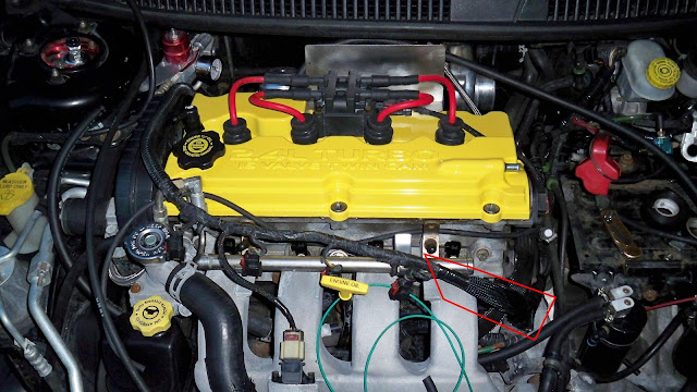

super easy install. if youre running a WOT box, only two wires need to be fed into the engine bay; MAP and WG line.
TPS can tee into ur WOT box, and the rest stay under the dash.
the map line is super clean and easy if you tee into it here (red box)
just cut a small slit in the loom, feed the green line up, and tee into the green/red wire, retape and then ur good to go!
