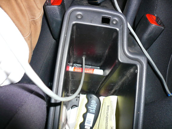

I got my Toybox 2.0 yesterday morning and finally got a chance to install it today and take it out for a spin. I now have my Toybox 2.0 in my arm rest with about 2.5 feet of wire so I have it coiled up in my arm rest all the time but when I'm drag racing, I'll be mounting it with a small piece of velcro on the HVAC surround bezel. Here's a list of things I used:

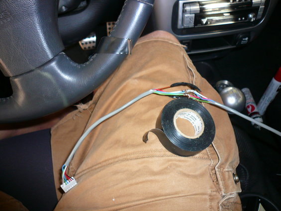

First and foremost, I disconnected the battery. I'm sure you can get away with it by not disconnecting it, but it's SOP for me. Next up I unmounted my Toybox 1.0 from my inner arm rest (re; I pulled it off it's double-sided tape) and pulled it out a bit exposing the wire bundle. I cut the old box off with about 8 inches left from the 1.0 box itself. Next I cut off some of the grey wire cover and stripped the individual wires. You can see what I'm talking about in these pictures:

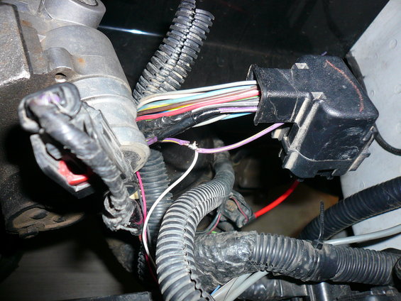

Basically, I just stripped the the wires and matched them up by color. Nothing against anybody using crimp on connectors, but I'm used to soldering all my connections. I just feel it's the most reliable, and there's nothing that pisses me off more than having to go through and check all my connections when a problem arises. I insulated each wire and taped the whole thing up. Next up, disconnect the white wire on the bottom PCI slot on the PCM. The instructions call for cutting the white wire and connecting it to the VIOLET/YELLOW wire, like so:
