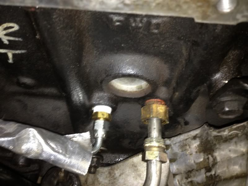

Oh one more thing.. i do have an aftermarket oil feed line however it has fittings on it. Wonder if the factory fittings in block will match up?
And does anyone know what size plug/bolt i need to block the coolant feed and return?

Coolant on the block is a 3/8 npt
The hose you can u a shaft of a 5/16
Bolt.

Oil line left side.
