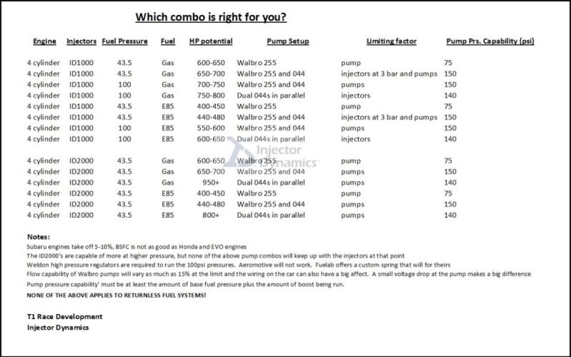

Also looking over that sheet that underarmor posted there is no mention of a single 044... Any chance anyone knows the limit of this pump used inline? I haven't gotten injectors yet so I can use whatever injectors are best. Also why does it seem like no one really uses a single 044 inline?

I use single 044 and the sheet does have 255 feeding 044 which I'd say not much different than single 044. I've heard 500 range is about all u get out of a single 044 on corn. + or -
I wish Nacho still posted He would have the answer in a heart beat.
I think he said it before in a thread (like Chief said) that a single o44 on corn will support around 500+ hp depending on injectors.
try this it should help alil choose your pump in the right hand corner
Fuel Demand Web App
