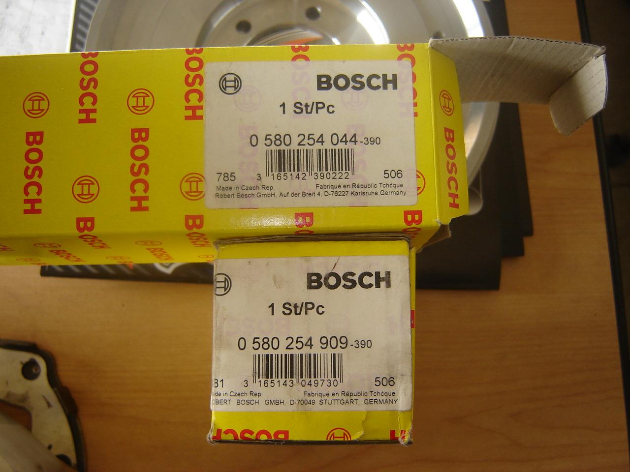

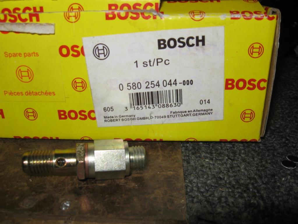

this website say's the 040 is good for 700hp
Bosch 040 Drop-in Fuel Pump (B5/B6 Audi A4) - Deutsch Teile Haus
damn
also i was doing some research and found out the real pumps say "made in Czech Republic."
http://www.rx7club.com/forum/attachm...4&d=1247222028
The fake pumps say "made in Germany"
http://www.rx7club.com/forum/attachm...2&d=1247190233
